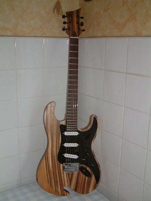

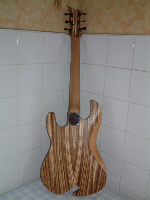

I get asked by my 4 daughters to make them guitars - unfortunately it's all electrics that they want . Well I finally gave in and made one for my youngest - Suzanna (15). She was a very demanding client and it was her design throughout - I just provided the wood and labour
It's based on a strat and used the elctric bits from a 3/4 sized Asian Squier copy that my friend had left over from putting together a "leftie" for his son. Interesting new tricks for me to learn and when in doubt I just treated it as an acoustic
She's called it Orion, and it has some pearl dot inlay on the back and headstock loosely symbolising the constellation Orion's belt. It is a zebrano and lime body (sounds like a drink!) with a Cedar of Lebanon neck (donated by my good friend Russell Rose) and EIR bound fingerboard. Zebrano front and back headstock veneer and black Gotoh tuners. Finish is Tru-oil on body and neck:
I managed to finish it on her birthday and it sounds and plays pretty good.

That's really cool Dave! Welcome to the electric world. I think the guitar is really nice, now you need to learn about making a set neck electric! (It's just that I like those better, others may not...my opinion, you know) And also, I think that the sound would be a lot better if you didn't use the cheapo pickups...unlike acoustic guitars, electric pickups have a whole lot to do with the final sound, as much or more as anything else on the guitar.

The great thing with these is that you can upgrade the electrics very easily - th body stays the same The cheapo's don't sound at all bad and are fine for Suzy to get started with her group (yes she has one formed already) and she is already becoming a mean guitar player. Sometime - I'm guessing sooner rather than later - a better set will be in there!

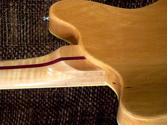

Dave, I've been looking for more pics, but I don;t have very many of electric guitar neck joints. Here's one, this is showing the back of a guitar that has a "PRS" style neck joint. That's become my favorite one to use, I've also used Les Paul type joints. This one basically is simply a tight pocket that is sized to fit the whole width of the neck. A "foot" on the neck that extends under the front pickup allows more gluing room. There's a lot of gluing surface here! I am finishing up another and the neck isn't glued in yet, so I can take a picture for you.
It becomes a little more complicated when you need to put an angle on the neck. That involves a jig that has a angled topside for the router to sit on as you route the neck cavity.
Melvyn Hiscock's Book "build your own electric guitar" is a great book, it'll show you everything you need to know!

Thanks. I'll investigate further. The thing I liked about the strat type bolt on was the very simple set-screw neck angle adjuster that goes in there. Made me feel very at home!!
